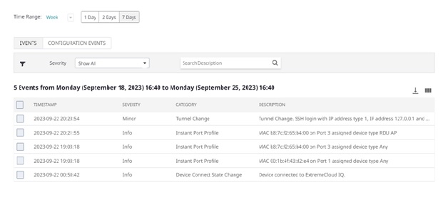

In the below example, MAC b8:7c:f2:65:b4:00 on Port 3 is assigned the device type RDU AP and is checked under the IPP category of Events.
Instant Port Profile matched device type are checked under Monitoring > Overview.
Instant Port Profile client MAC addresses are checked under Monitoring > Clients. Select the client MAC to check the current connection status of the connected client.
